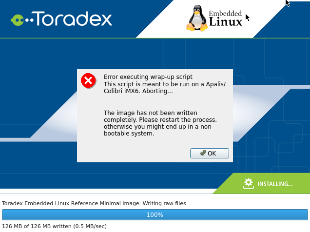

Validation for the new Product Configurations
New Product Configurations without WinEC will be shipped with new Toradex Easy Installer version 5.7.5. The new Product Configurations have not undergone any hardware changes compared to the previous versions with Windows EC, so little to no impact is expected on the end application. Anyways, Customers should validate their software in the new Product Configurations to ensure the application is working properly.
Customers should give specific attention to the production/factory programming setup, specially in case of using any custom scripts, as the new Toradex Easy Installer versions present differences in that regard.
Customers don't need samples of the new modules to validate the new Toradex Easy Installer version. Customers can perform the validation process using the previous modules with WinEC by following the steps below:
- Get a module with Windows EC, corresponding to the new module without Windows EC, according to the Product Portfolio Update table.
- Download the Toradex Easy Installer 5.7.5 version, following this steps to download Toradex Easy Installer.
- Load the correct version of Toradex Easy Installer previously downloaded to the module according to Loading Toradex Easy Installer.
- Select and install the Toradex Easy Installer version 5.7.5 into the module.
- Boot your module with the new Toradex Easy Installer version installed and using serial port execute commands on the U-boot to recreate the config block accordingly to Handling and Re-creating Toradex Config Block (cfgblock) on U-Boot.
- Run your production programming setup and adjust if needed.
Examples
In order to make entering Toradex Easy Installer's U-boot easier, we recommend flashing the correct version of Toradex Easy Installer on the module, rebooting and then accessing the U-boot.
Example with Colibri iMX6 (eMMC)
A customer has a 00151100 Colibri iMX6DL 512MB V1.1A with the serial number 10706262 with Windows EC, but does not want to wait for the new modules. They can change the serial number to match a 00791100 Colibri iMX6DL 512MB V1.1A, which corresponds to the same module version without Windows EC. After installing the correct version of Toradex Easy Installer and entering the boot, the config block can be configured:
COLIBRI IMX6 TEZI # cfgblock create -y 0079110010706262
