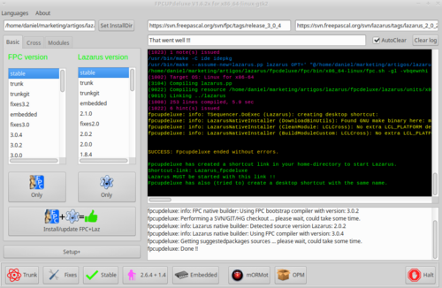

Select the version for both FPC and Lazarus then click on the install button. The following image represents a successful installation log:
FPC and Lazarus successful installation log

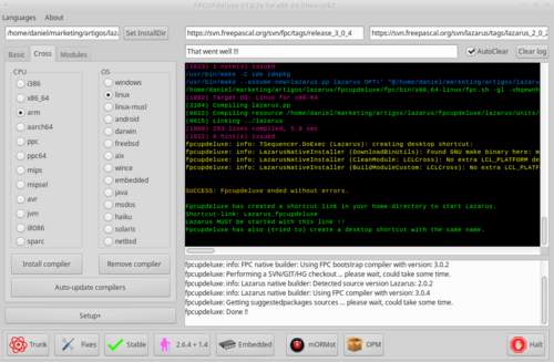

Next, select the CPU and the OS for the compiler on the Cross tab, in this case we will choose the arm CPU and the linux OS. Finally, press the Install compiler. Below is an image representing a successful installation log:
Compiler successful installation log

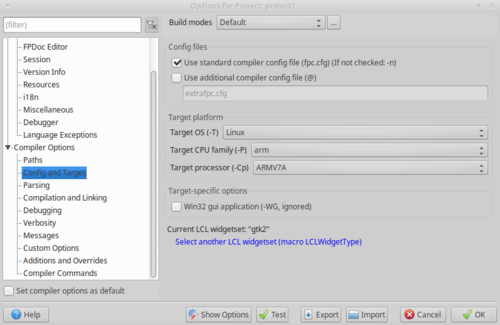

For configuring the compiler options, go to Project -> Project Options -> Compiler Options -> Config and Target and change the fields on the Target platform topic, see below:
