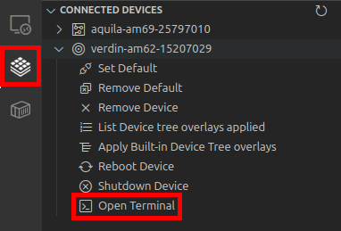

Using the Visual Studio Code Extension for Torizon
Make sure to add your device first.
Then, on the Torizon extension view, under Devices, choose your device and click the SSH Terminal button:
  • Connect via SSH Using the Visual Studio Code Extension for Torizon
