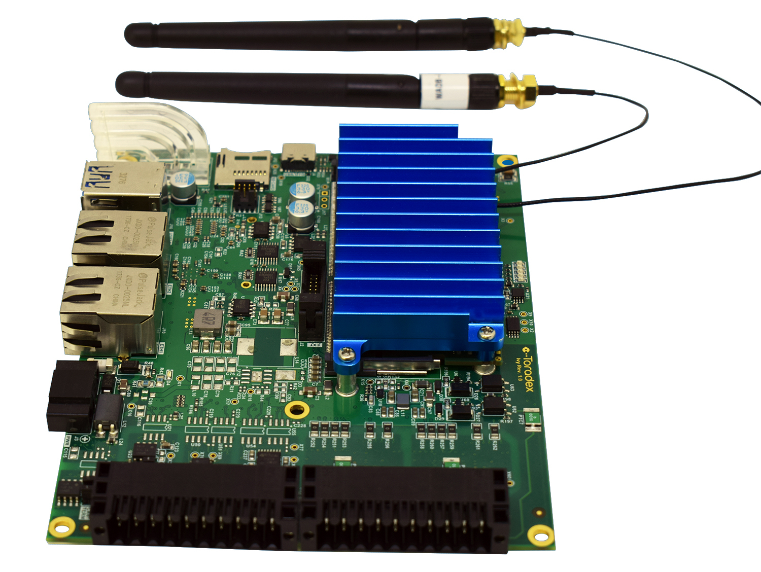

Step 2 (Optional)
info
Please note down the module serial number before attaching the Heatsink — it’s the easiest way to connect via SSH later!
Screw the Verdin Industrial Heatsink on top of the SoM, using the screws that come with it:
Ivy Carrier Board With the Verdin Industrial Heatsink

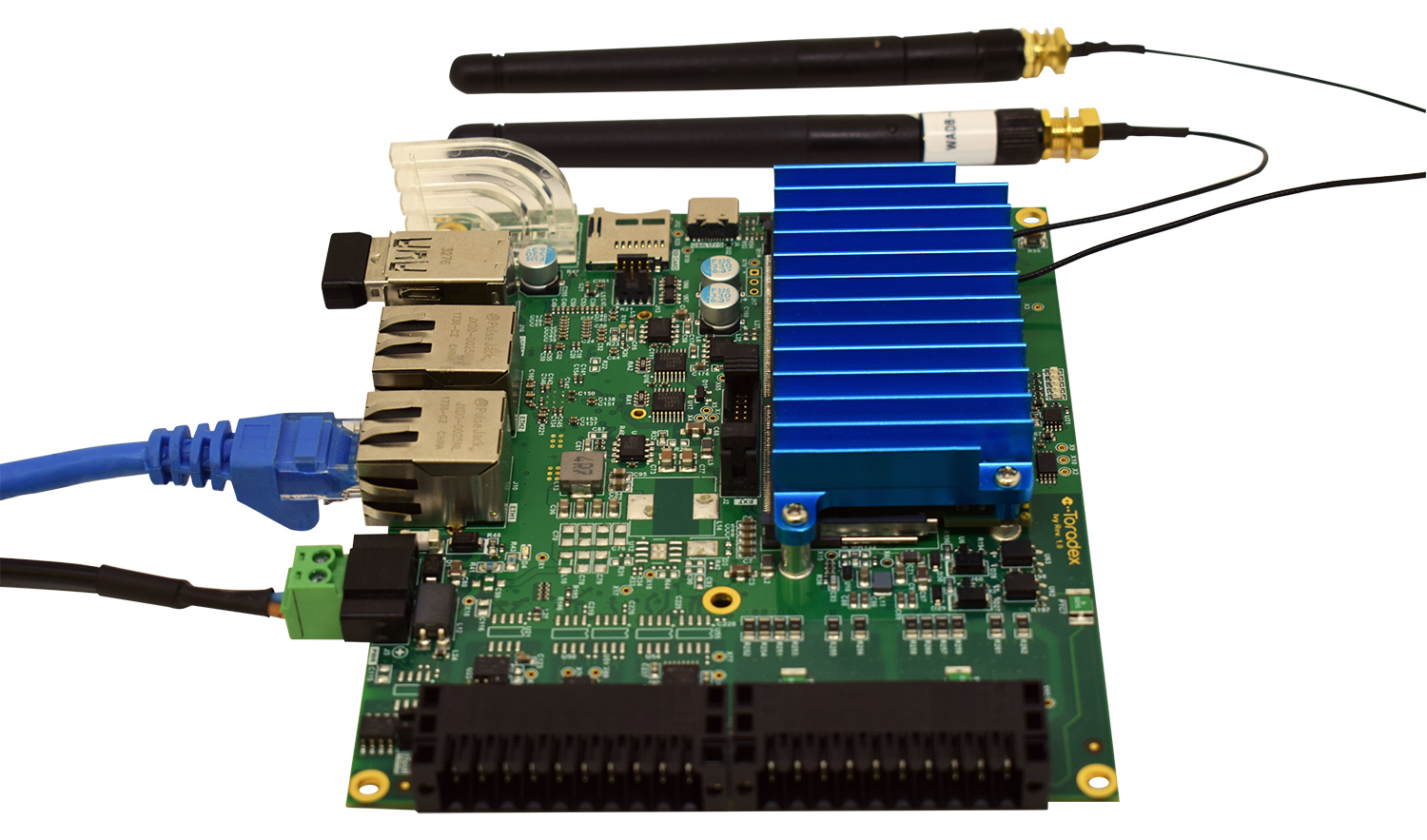

Step 3
3.1 Plug a USB keyboard/mouse into the Ivy Carrier Board's USB 3.0 (J16) connector(s).
3.2 Plug the Ethernet cable into the Ivy Carrier Board's GBIT ETH (J7) connector.
info
The network shall be capable of providing the module with an IP address (via DHCP) and internet access.
3.3 Plug a USB Type-C to Type-A cable into the DRP (J4) connector if you want to enter Recovery Mode and load the Toradex Easy Installer.
3.5 Plug the power supply into the Ivy Carrier Board's power connector (J3).
HDMI, Ethernet, USB keyboard, USB Type-C to Type-A cable and power supply connected to the Ivy Carrier Board Carrier Board
danger
Double-check that your power supply is within the rating board limits (8-32V for the J3 connector) and that the polarity is not reversed. Also, ensure the power supply's current capacity is sufficient, or the system may shut down unexpectedly. For evaluation purposes, a 12V 2A power supply is recommended.
