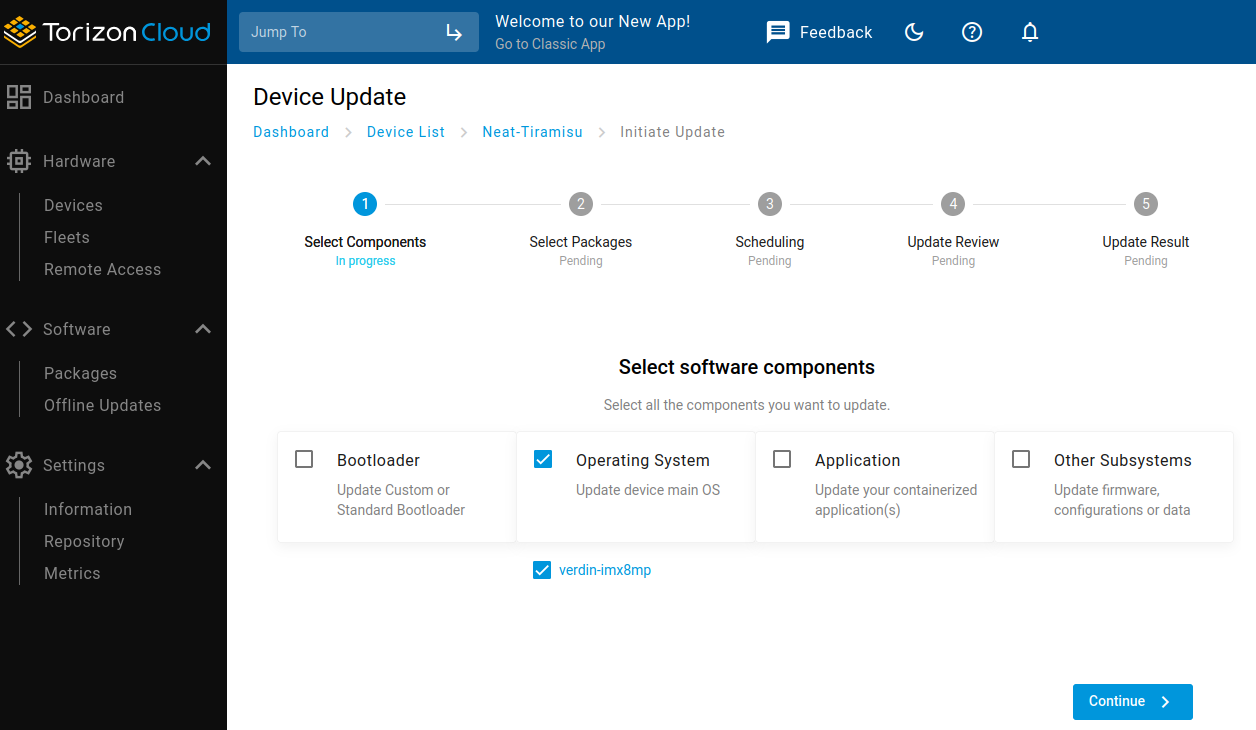

Step 2
Go to the device page again and initiate an update in your device:
Step 3
3.1 Select the Operating System option.
3.2 Select the latest "Monthly" release available of torizon-docker image from the Torizon Monthly feed.
3.3 Please note that the update process will take some time. You can monitor the progress of the update through the icon located at the bottom-left corner of the screen.
