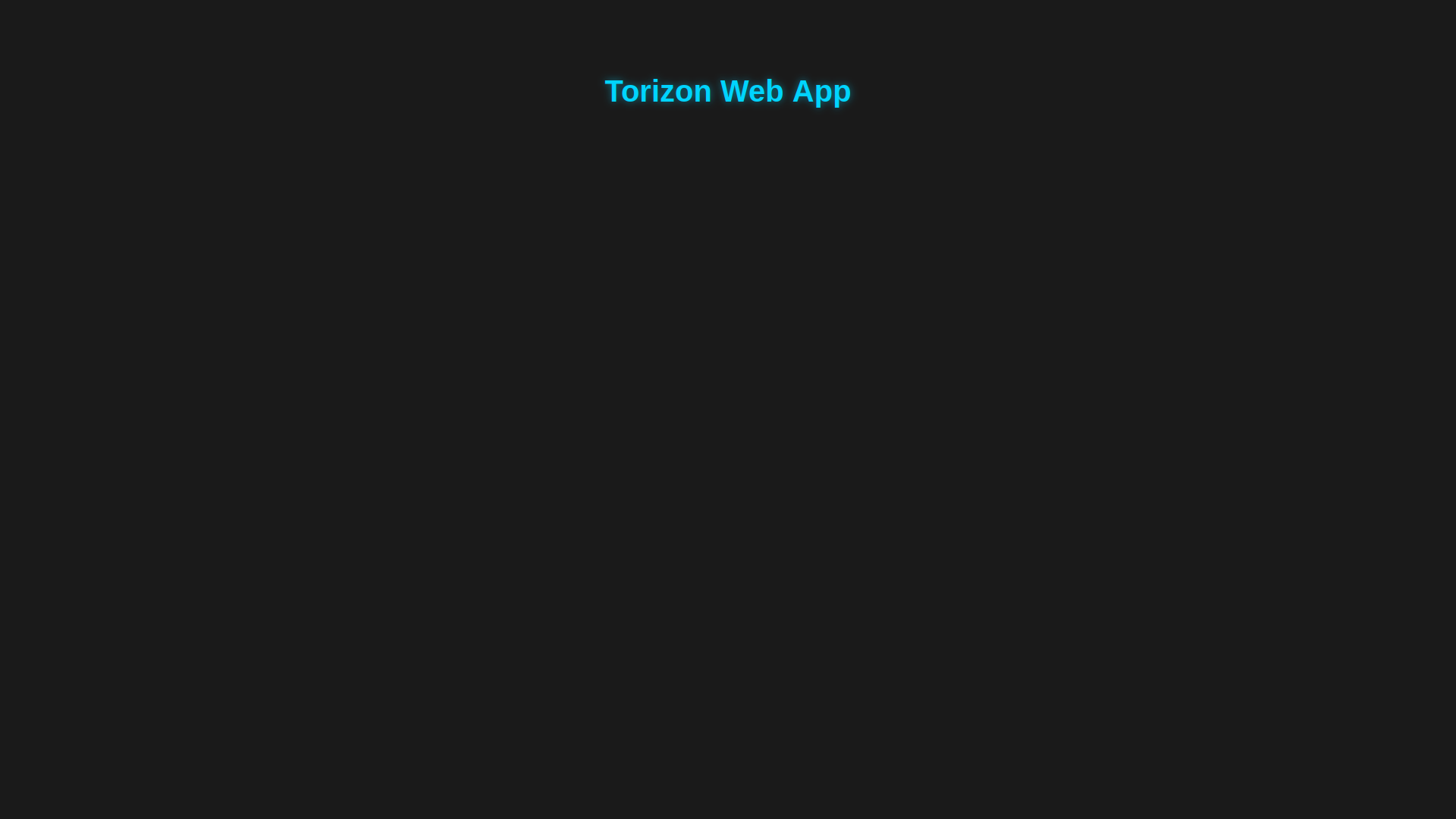

The sample is a static web page that Chromium loads from the container filesystem. It renders a Torizon Web App heading and prints Hello Torizon! to the browser console.

The web application starts from the src/index.html file:
<!DOCTYPE html>
<html>
<head>
<meta charset="UTF-8">
<title>Torizon Web App</title>
<link rel="stylesheet" href="css/style.css">
</head>
<body>
<h1>Torizon Web App</h1>
<script src="js/app.js"></script>
</body>
</html>
