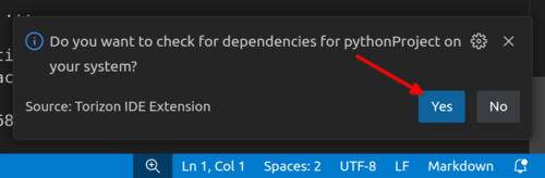

During the first load of a new project, the notification Do you want to check for dependencies on your system? appears. Click Yes to proceed with the dependency check.
The extension then triggers the check-deps task, which checks the necessary local packages (on the development host, such as SDKs) to build the project. For more information, refer to the Check Host Machine Dependencies Required by the Project documentation.
If the notification does not appear, trigger the check-deps task manually. For more information, refer to the Workspace - Tasks documentation.
The task then requests the sudo password. Confirm the installation of the dependencies.
