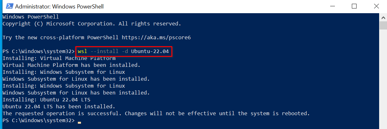

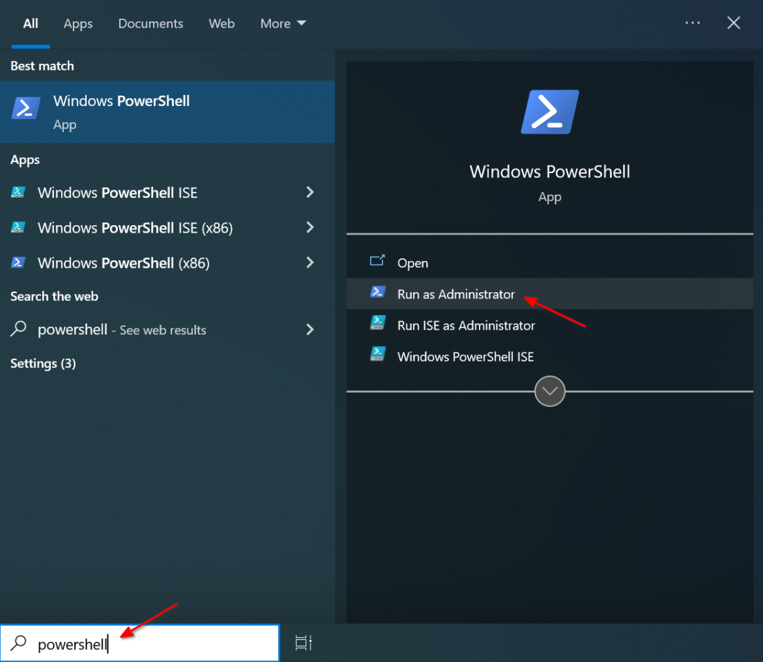

  1. Open Powershell as administrator.
  2. Install WSL: use the wsl --install -d Ubuntu-22.04 command.
    info
    Toradex recommends using Ubuntu 22.04. If you are familiar with a different Linux distribution, refer to the WSL documentation to ensure a correct installation, then follow the instructions in the Linux section to install Docker Engine.
  3. Restart your PC.

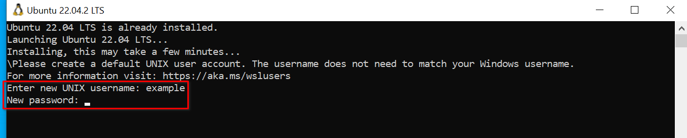

  4. A WSL terminal will be automatically opened. Do not close it!
  5. Input a username and password: you will use this password when running sudo commands in the WSL terminal.

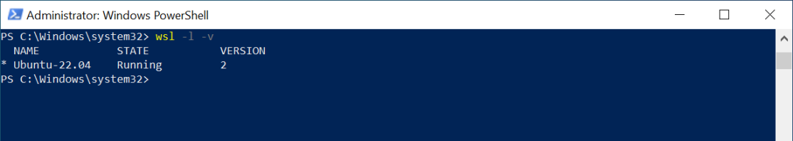

How to check the default Linux distribution of WSL
You can check the installed and default distributions of WSL by running the following command in PowerShell:
$ wsl -l -v
For detailed information, refer to the WSL documentation.

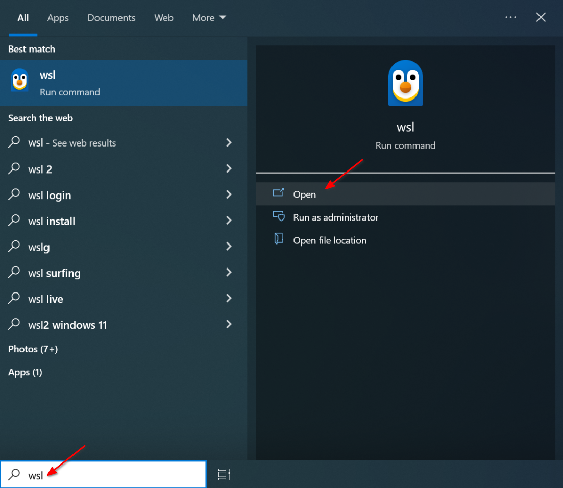

  1. Open a WSL terminal: you can search for wsl in the Windows search bar.

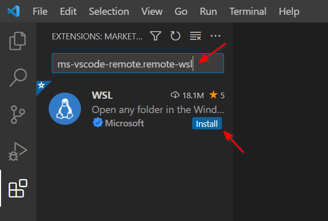

Install WSL Extension
The Visual Studio Code IDE enables you to work in the WSL filesystem, providing access to the Linux environment directly from Windows. It includes the git revision control system, Docker command line tools, and more.
To install the WSL extension, proceed with the following steps:
  1. Click the Extensions icon from the left menu bar in Visual Studio Code.
  2. Search for ms-vscode-remote.remote-wsl. Click Install.
