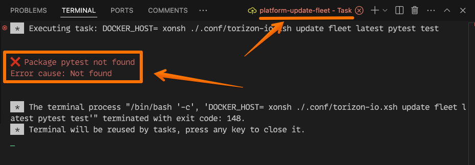

If you are getting the following error message when trying to trigger a fleet update after run the platform-update-fleet task:
alt
warning
This package should be created first by running the tcb-platform-publish task.
Make sure that the package exists in the Torizon Cloud.
