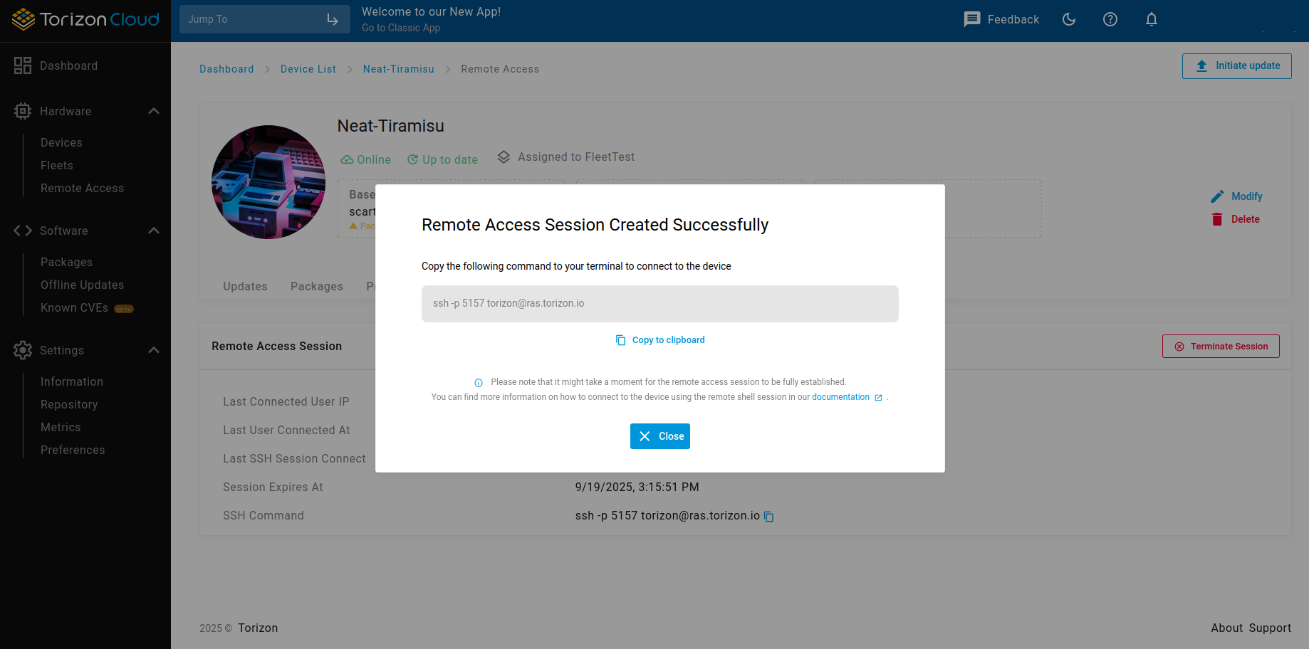

4. Connecting to a Remote Device​
4.1. On https://app.torizon.io, go to the Devices page, click on your provisioned device, and then, on Remote Access, click on the Initiate Session to start the session.
4.2. Copy the command printed on the screen to the terminal on your host computer to remotely connect to the device. The command will be similar to the following example:
$ ssh -p <port> torizon@ras.torizon.io
Alternatively, if you have multiple keys set up on your host computer and/or your Torizon Cloud account, you can use the following command to specify which key to use:
$ ssh -v -o "IdentitiesOnly=yes" -i <your_key_filename> -p <port> torizon@ras.torizon.io
4.3. After you have finished your remote session, get back to the Remote Access Manager on the Account page and close your session at the bottom of the page, on the Active Remote Sessions.
