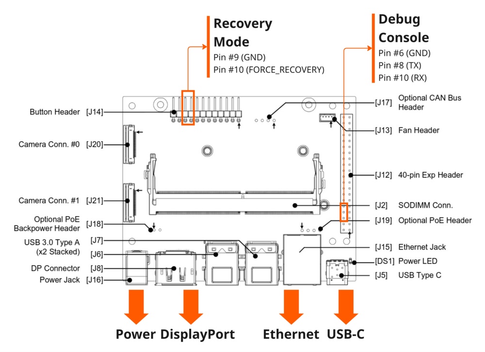

  2. Setup the board with cables as shown on the picture below.
  3. Connect the USB port to the host machine and put the target board into the recovery mode: short the FORCE_RECOVERY pin (labeled as FC_REC on the carrier board) to the ground, this can be done by installing a wired jumper to the contacts 9-10 of the J14 button header on the carrier board (refer to the Jetson Orin Nano Developer Kit Carrier Board Specification), then power on the board.
    Jetson Orin Nano Hardware Setup
