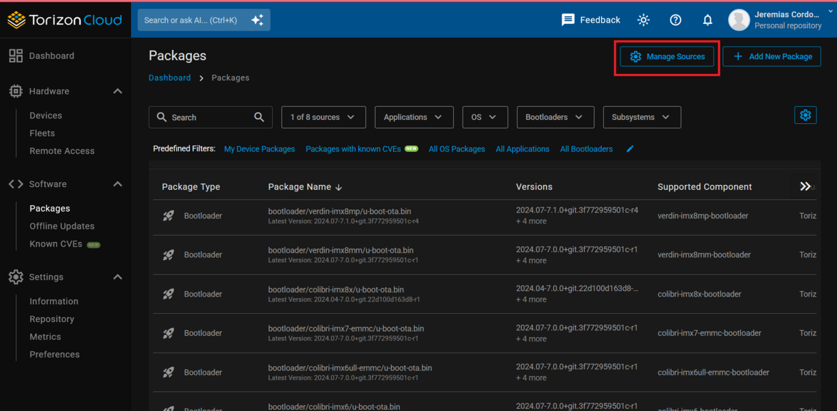

In the Torizon Cloud Web UI, open the Packages page and select Manage Sources in the top-right corner. From the list of package sources, select the edit button for a source to reveal the URL of its delegation JSON file. Use that URL to download or view the file.

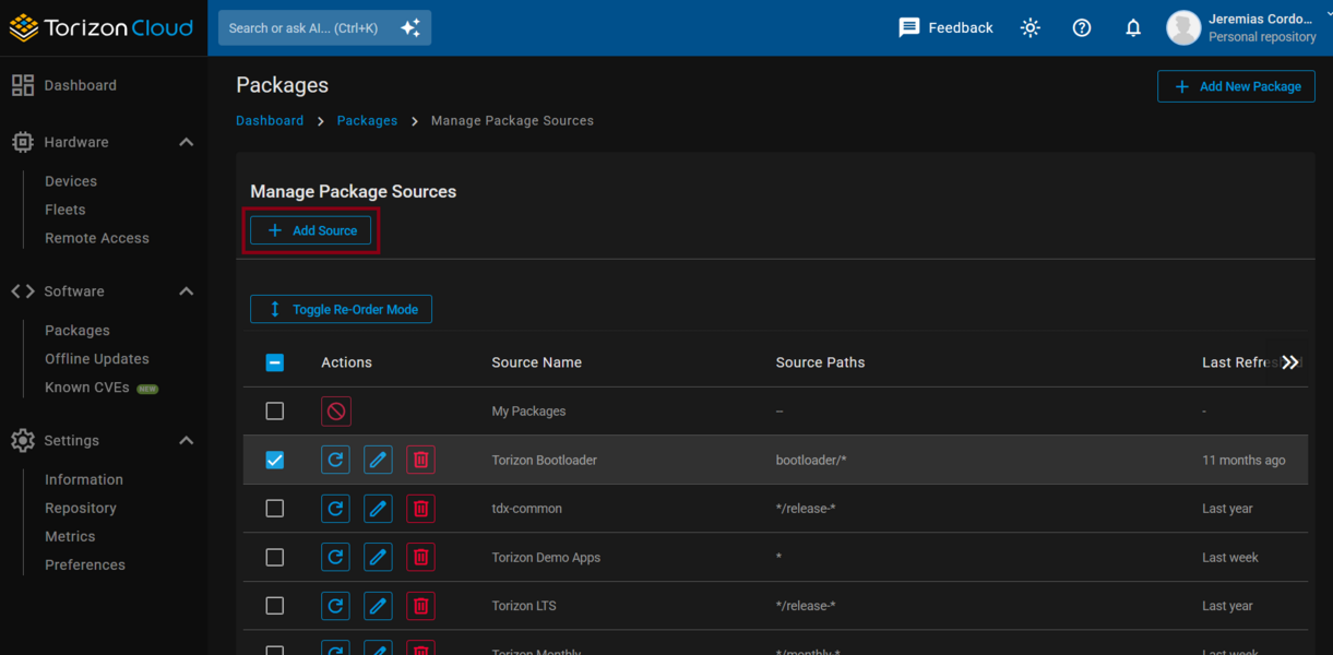

  1. Open the Packages page on the target Torizon Cloud account, then select Manage Sources in the top-right corner:
  2. Select the Add Source button:

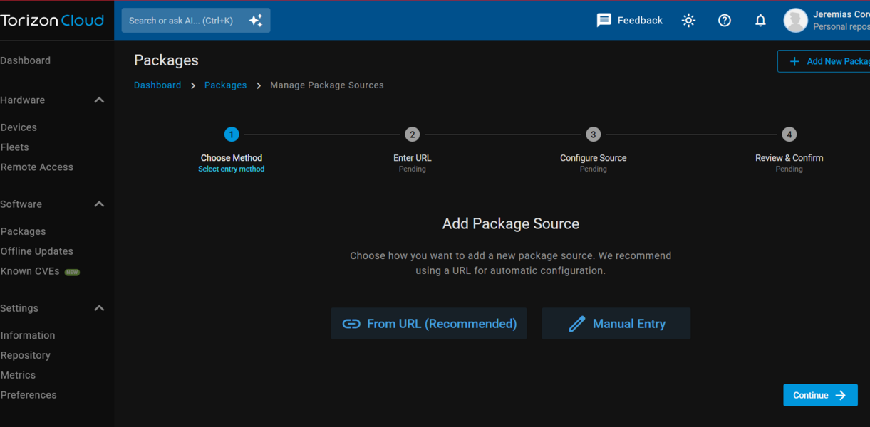

  3. Choose the From URL (Recommended) option:

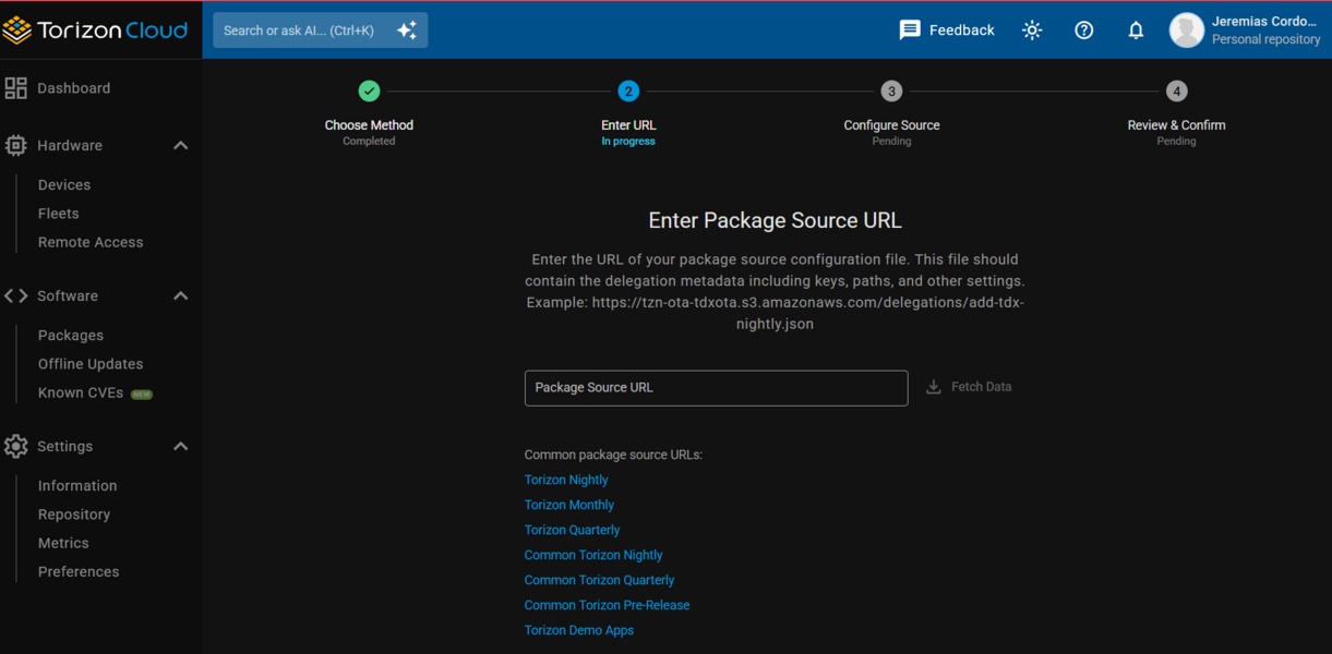

  4. Paste the URL of the delegation reference JSON file hosted in the previous step:
This file provides the information that the Web UI needs to add the new package source.
