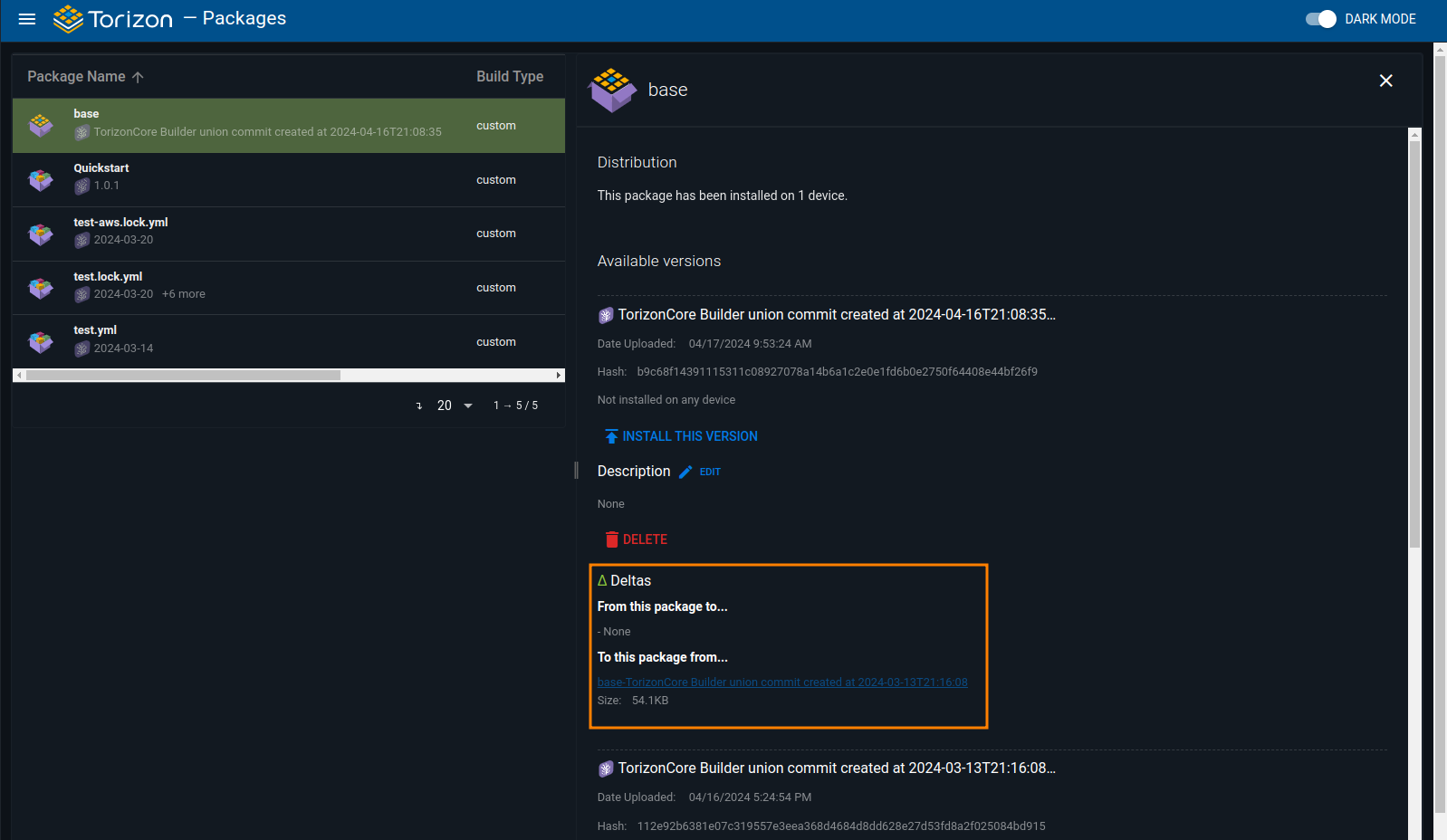

Creating and Deploying a Static Delta OS Image Update
Static delta generation pre-computes a binary diff between two specific OS packages, making that particular upload path more efficient.
As an example, you pushed a customized image to Torizon Cloud:
$ torizoncore-builder platform push --credentials credentials.zip base
And deployed the image to the modules on the field.
Later on, you updated that image to a newer version and pushed the updated version to Torizon Cloud:
$ torizoncore-builder platform push --credentials credentials.zip --package-version newer base
From this point, you have 2 options:
- Initiate the update on the module;
- This will require the module to download all new and changed objects before updating.
- Create a static-delta and update the module with the delta;
- This way, the module downloads only difference between the versions in the changed files.
To create a static-delta and push it to Torizon Cloud, you need the hashes of the old version and the new version.
The OS package Hash can be found by inspecting the OS package on your Torizon Cloud Platform account. The OS package must be accessible on your Platform account.
$ torizoncore-builder platform static-delta create --credentials credentials.zip <FROM_HASH> <TO_HASH>
From the torizon platform, click in the package you created the static-delta. You can see the push worked from this new field, "Deltas"
