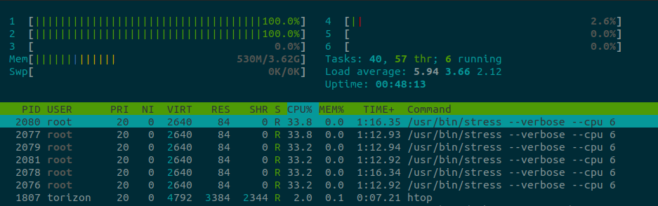

  1. Open another terminal and launch htop. You should see something like this:
Stress Core 0 and 1
