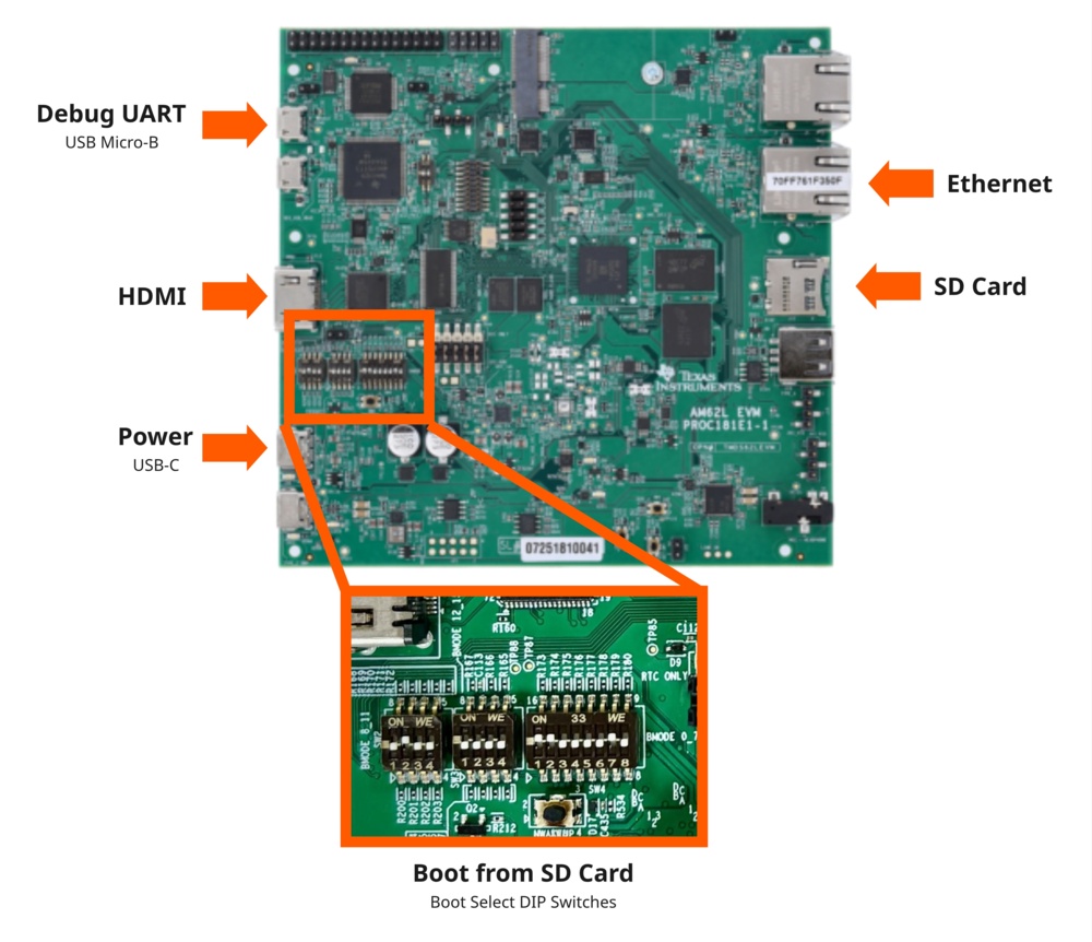

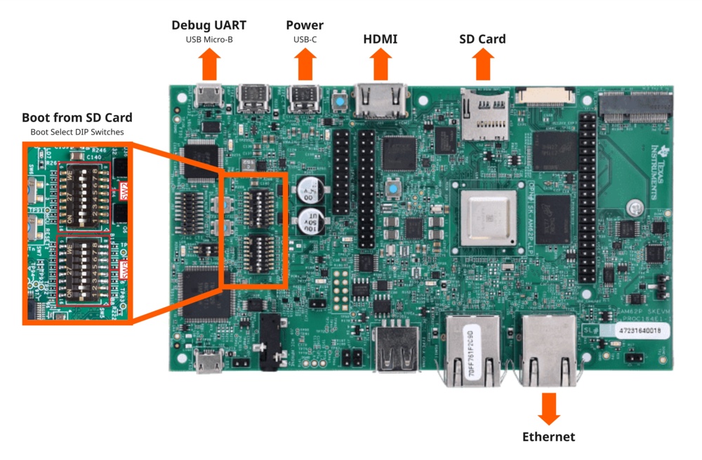

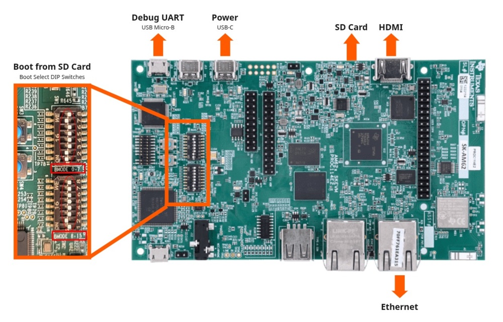

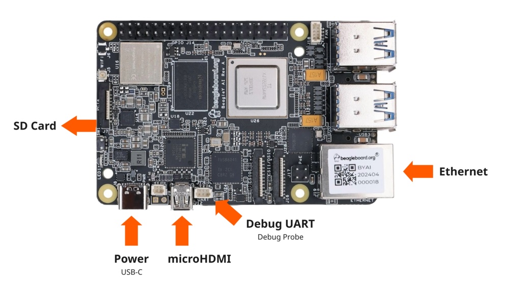

.wicfile to a micro SD card and insert it into the board. For example, if usingddto flash the image, double-check the device name of the SD card withlsblk, make sure it's unmounted, then run the command below:$ sudo dd if=<image-name>.wic of=/dev/<sdcard-device-name> bs=4M status=progress - Configure the board for SD card boot and connect the UART interface to the host PC:
For more information regarding hardware setup, refer to TI's Resource Explorer.
