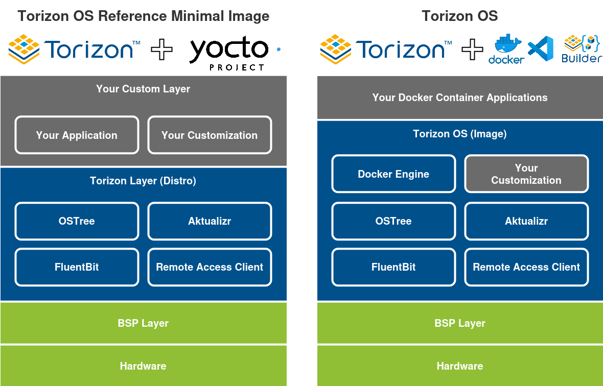

The reference minimal image gathers the elements of the Toradex BSP and Torizon layers. In other words, it contains the Linux kernel, drivers, configurations and the necessary Yocto Project layers to customize, configure, and build it. This is shown in the diagram below:
Application Architecture with Torizon OS
In addition, it also contains the necessary structure to allow you to remotely update your system. For more information, refer to the section Torizon updates: OSTree and Aktualizr.
Furthermore, the notable difference from the Torizon OS is that Torizon OS takes the basic elements of the reference image and adds the container runtime resources, making it a ready-to-use Linux-based operating system for you to develop your application. If you are looking for more information about Torizon OS, refer to Torizon OS Technical Overview.
