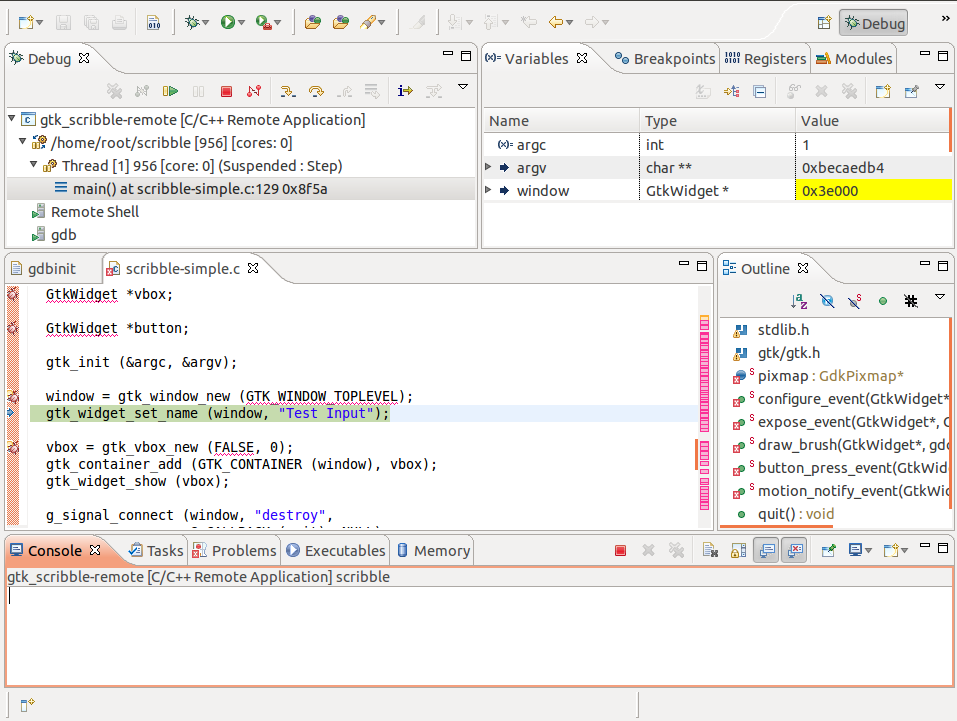

Debug an Application in Eclipse​
To debug an application on the target device which is controlled by the development host the following components are used:
  • Eclipse is used to setup the target device and the development host.
  • An SSH connection is used to start things on the target device.
  • On the target device, the gdbserver is used to start and control the program to be debugged.
  • On the development host gdb is started and a connection to the gdbserver over Ethernet is established.
  • Eclipse is used as a graphical front-end to gdb.
Creating a Debug Configuration.​
Menu options --> Run --> Debug Configurations...
Create a new 'C/C++ Remote Application' launch configuration
Give it a Name
In the Main tab
  • set the C/C++ Application (Note: Depending on the Eclipse version the order of input fields might be different)
  • set the Eclipse Project
  • use the RSE Connection already defined, or create a new SSH connection if you are not using the Remote System Explorer
  • set the C/C++ Application on the Target (Note: If you don't get the Remote Absolute File Path try first configuring a regular run configuration)
  • click Apply
Debug Configuration, Main Tab
In the Debugger tab
  • set the path to the cross debugger: /home/toradex/gcc-linaro/bin/arm-linux-gnueabihf-gdb
  • set the GDB command file, e.g. to gdbinit
  • click Apply
    Debug Configuration, Debugger Tab
The debugger needs access to the shared library files used on the target device, so if a shared object file is opened by your application on the target device it can read that same file from a storage location on the development host. Create the GDB command file in the Eclipse project and set solib-absolute-prefix to point to the rootfs used on the target device:
set solib-absolute-prefix /srv/nfs/rootfs
Starting to Debug​
  • Open the Debug Configuration you just created and click Debug
  • If asked, enter info for the Remote System Explorer
  • If asked, confirm the switch to the Debug perspective
  • Happy debugging
