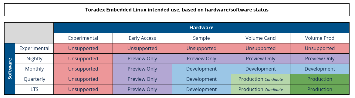

Quarterly Embedded Releasesβ
Typical Content: Latest feature set, bug and security fixes Release Cycle: During active state, typically at the start of each Quarter, 4 times a year Maintenance Duration: 3 Months after the release. During this period, we can deliver critical fixes through patch releases.
Maintenance Releasesβ
Typical Content: Feature set of the latest release during active state, plus bug and security fixes Release Cycle: Typically released during maintenance state, typically at the start of each Quarter, 4 times a year. Maintenance Duration: 3 Months after the release. During this period, we can deliver critical fixes through patch releases.
Pre-releasesβ
Engineering Pre-releasesβ
Typical Content: Early silicon enablement, upstream BSP integrations, experimental features, and initial support for new kernels and hardware accelerators Release Cycle: Irregular, coupled with upstream SoC vendor updates and development milestones Maintenance Duration: Short-term availability with no guaranteed maintenance, updates, or continuity1
Nightly Embedded Pre-releasesβ
Typical Content: Features and fixes, made that day Release Cycle: On most nights, before midnight Maintenance Duration: Not maintained as it is released on most days
Monthly Embedded Pre-releasesβ
Typical Content: New Features and bug fixes Release Cycle: Typically every month Maintenance Duration: Not maintained. For patches, use nightly builds
