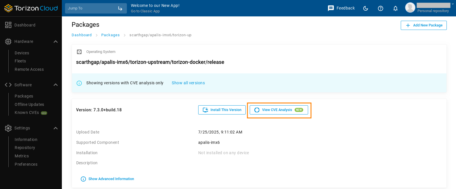

You can download the SBOM for Torizon OS Quarterly Releases directly from the package detail view: 'Dashboard > Packages > <package name>'.
Learn how to download SBOM CycloneDX + VEX by checking the images below (click and slide or use the arrows):
View CVE Analysis
Download SBOM CycloneDX + VEX from Torizon Cloud
(Double-Click to Zoom)
