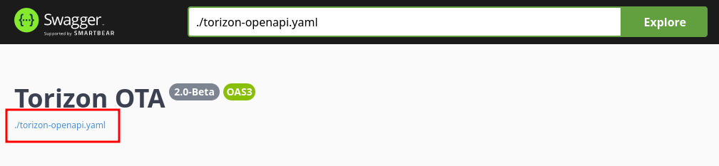

You can learn the API specifications on our Reference Documentation .
To download the OpenAPI specification file, click ./torizon-openapi.yaml:

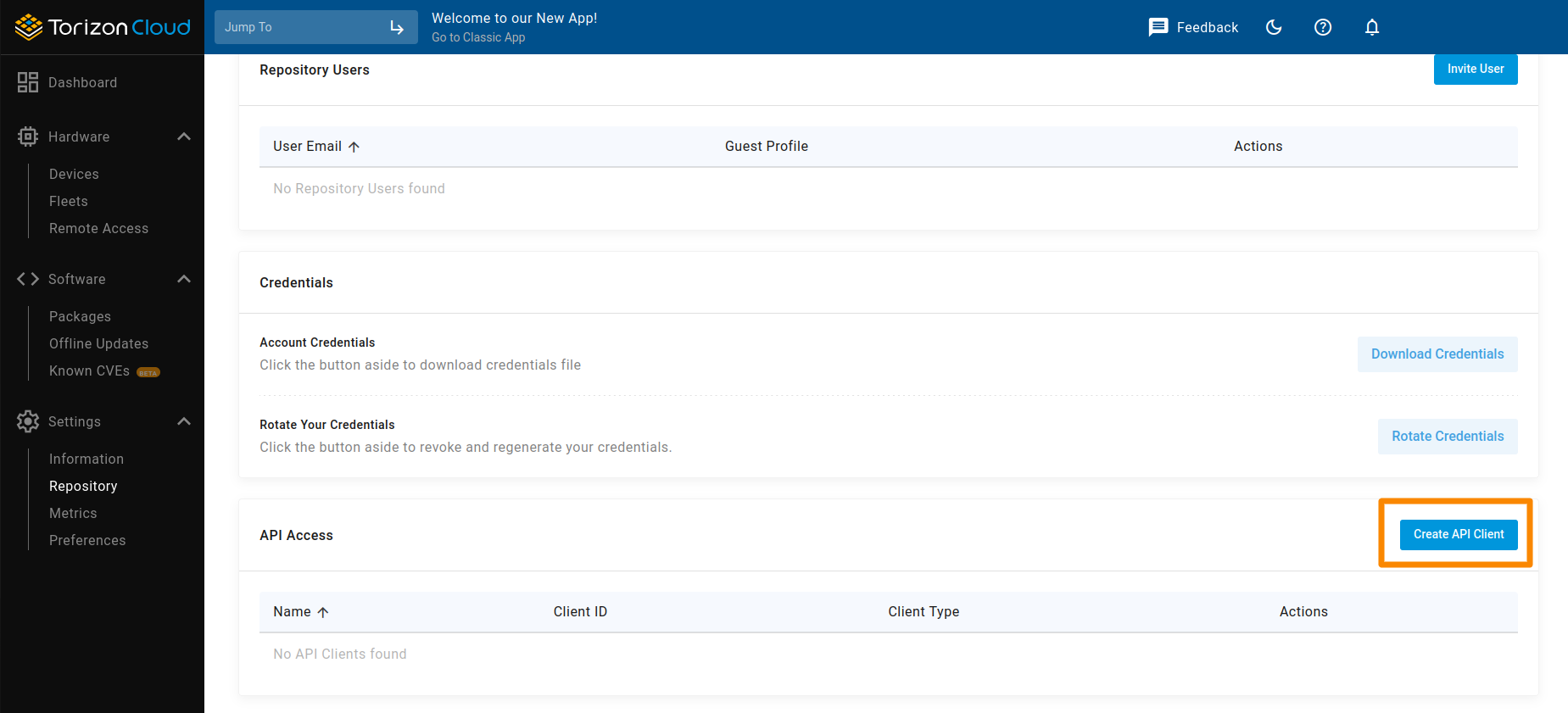

1.1. Enter your Torizon Cloud account. On the Repository section (under Settings), click Create API Client:

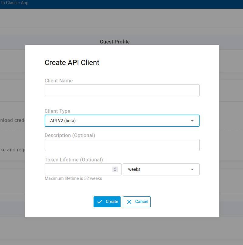

1.2. Give the API Client a name and a description. Select the API V2 (beta) Client Type:
1.3. Click or select the Client Secret field to copy and use it during your testing and integration procedures. Note that you won't be able to see the secret after closing the form:
