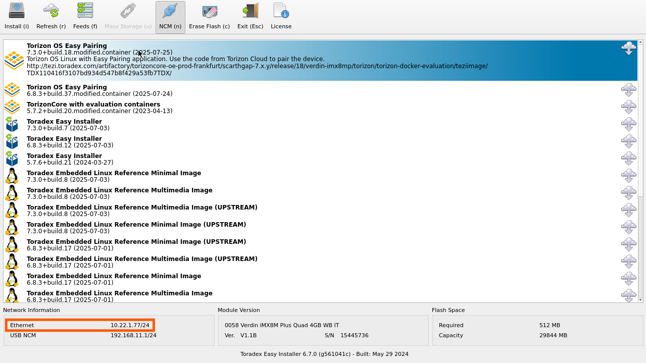

Take note of your module's IP address, as highlighted in the picture below. You will need it for the next lessons. The /24
at the end is just the IP mask, please disregard it.
The IP address in the example above is 10.22.1.192

To install Torizon, use the arrow key buttons of the connected keyboard or the mouse to navigate and select the latest version of Torizon OS Easy Pairing
, click the Install
icon to install, and press Enter
to confirm, and accept the License Terms:
