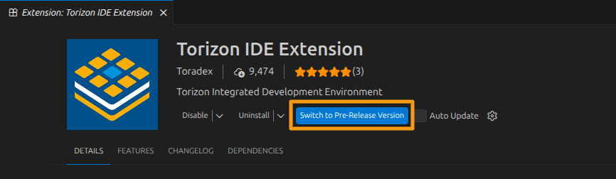

Switch to Pre-Release​
You can switch the Torizon IDE Extension to its pre-release version directly through the Visual Studio Code Extension tab.
  1. Click the Extensions tab and search for the Torizon IDE Extension.
  2. On the Torizon IDE Extension details page, click the Switch to Pre-Release Version button.
Once clicked, the Pre-Release version of the extension will be downloaded and installed automatically by Visual Studio Code. Note that you can revert to the stable version by clicking on the Switch to Release Version button.
