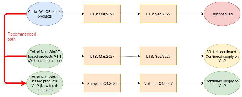

In our current portfolio, we have Colibri iMX6 variants offering versions with and without a WinEC license. They are:
Product | MPN with Windows EC License, which will be phased-out | MPN - Without Windows EC License, to migrate to |
Colibri iMX6S 256MB | 0014XXXX | 0077XXXX |
Colibri iMX6S 256MB IT | 0016XXXX | 0078XXXX |
Colibri iMX6DL 512MB | 0015XXXX | 0079XXXX |
Colibri iMX6DL 512MB IT | 0017XXXX | 0080XXXX |
Apart from the WinEC EOL, non-WinEC variants will face a version change to address a touch controller EOL. Therefore, for customers migrating from the WinEC EOL, the most recommended path is shown below:
Replacement Option | Product Comparison | OS / Software Stack to migrate | Remarks | Migration effort (HW+SW) |
Colibri iMX6 Solo without WinEC license | Not applicable - Products have the same spec, the only difference being that this replacement option does not offer the WinEC license. |
| Low (Software Only) |
Colibri iMX6 DualLite without WinEC license | Not applicable - Products have the same spec, the only difference being that this replacement option does not offer the WinEC license. |
Colibri iMX8X | Colibri iMX8X Quad Colibri iMX8X Dual |
| Low |
Verdin Family | Verdin iMX8M Plus Verdin iMX8M Mini Verdin AM62 Verdin iMX95 |
| Medium |

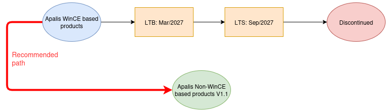

In our current portfolio, we have Apalis iMX6 variants offering versions with and without a WinEC license. They are:
Apalis iMX6D 512MB | 0029XXXX | 0082XXXX |
Apalis iMX6Q 1GB | 0027XXXX | 0083XXXX |
Apalis iMX6D 1GB IT | 0035XXXX | 0084XXXX |
Apalis iMX6Q 2GB IT | 0028XXXX | 0085XXXX |
The most recommended path is shown below:
Apalis iMX6 without WinEC license | Not applicable - Products have the same spec, the only difference being that this replacement option does not offer the WinEC license. |
Apalis iMX8 | Apalis iMX8 QuadMax Apalis iMX8 QuadPlus |
| Low |
| Medium |
