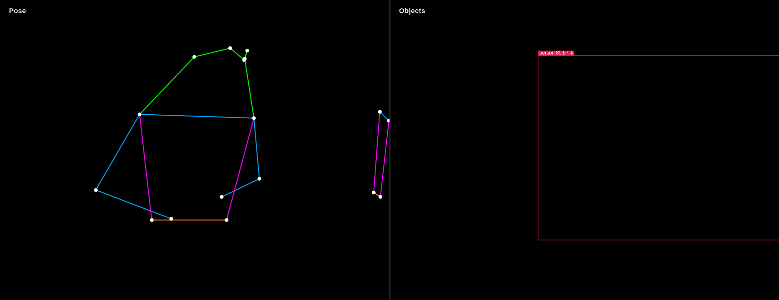

Expected Results​
After startup, the HDMI display shows two side-by-side video feeds, each annotated with the inference results from its respective pipeline:
  • The object detection feed draws bounding boxes with labels around detected objects
  • The body pose feed overlays skeleton keypoints on detected people
The same output is also accessible remotely by opening a browser and navigating to http://<BOARD_IP_ADDRESS> in the same network as the Luna SL1680. The web output shows the same annotated video feeds as the HDMI display.
