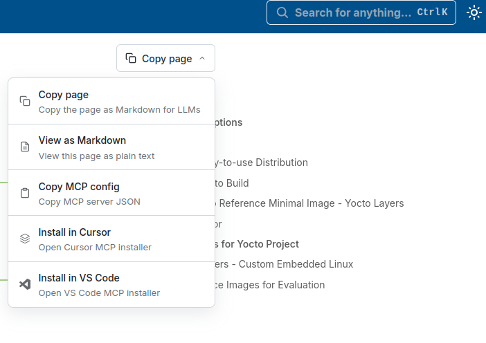

Use the Developer Center Setup Shortcuts
On a desktop browser, you can copy or install the MCP configuration from any Toradex Developer Center article:
  1. Select Copy page near the table of contents.
  2. Select one of the following options:
    • Copy MCP config copies the Toradex MCP server JSON. Paste the server entry into the MCP configuration for your client.
    • Install in Cursor opens the native MCP installer in Cursor.
    • Install in VS Code opens the native MCP installer in Visual Studio Code.
  3. Review and approve the server configuration in your client.
  4. Confirm that the Toradex tools appear in the client's MCP server or tools list.
Toradex Developer Center Copy page menu with MCP configuration shortcuts
If your browser does not open an editor from an installation link, use the manual configuration for that client in this article.
