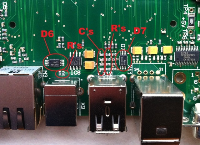

Orchid Carrier Board USB 2.0 Patch
- Remove 4 capacitors(C's).
- Replace 6 resistors with 0 Ohm resistors or with a solder bridge (R's).
- Remove D6 and D7 (ESD protection). Be very careful to not remove the pads!!
