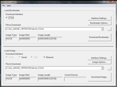

Downloading and flashing the image​
  1. Download the latest image and bootloader for PXAxxx here.
  2. Start ColibriLoader.
  3. In the Load Image section, under "Downlaod Interface", select "Ethernet".
  4. Under "File to Download", click on the button "..." and provide the path to the folder where the image and bootloader have been downloaded in step 1.
  5. Press "Download Image..." button
    A Window saying Waiting for Device to Respond will appear.

Downloading and installing the bootloader via JTAG​
  1. Download and install the Amontec driver or Olimex driver.
  2. Download the latest image and bootloader for PXAxxx here.
  3. Plug the JTAG adapter directly onto the Evalboard's JTAG connector. Check for the correct polarity (pin 1 position).
    This is X13 on the Evaluation Board V3.1A, V2.1 and X20 on Evaluation board V1.1.
  4. Switch on the Evaluation Board.
  5. Start the ColibriLoader Tool.
  6. In the Load Bootloader section, click on Interface Settings.... In the JTAG Interface Settings, select Olimex / Amontec USB to JTAG. Click on OK.
  7. In the Load Bootloader section, under File to Download, click on ... and provide the path to the folder where the image and bootloader have been downloaded in step 2.
8.Press Download Bootloader... Button. The Download can take a few minutes, depending on the module type and bootloader size.
